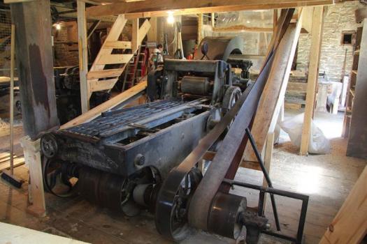

A Working Museum
Some machines, like this planer/sticker, have many moving parts and require lots of gears for proper operation. Even though these machines are ancient, they work very well. It felt to me like the Hope Mill was a working museum.
