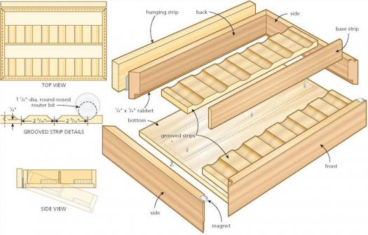

Full-size drawing
With the spice bottles at my side, I drew the spice rack and hanging strip full-size on a piece of 1/4″ plywood. There was just enough space to fit two rows of spice jars, with a bit of room to grasp the jars, so space had to be used carefully. I worked from the outside inwards when designing, as the exterior of the rack was the only fixed dimension. I could have squeezed one more spice jar into each row, but felt it might be tough to easily grasp each jar if I did.

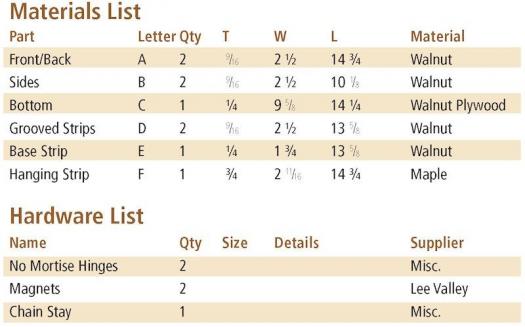

Assemble your ingredients
Minimal lumber is required for this project. I would also recommend you have the hardware on hand before starting. I broke out the walnut stock for the sides, front and back, and milled them to size. Mitres were cut onto their ends with my cross cut mitre sled, but a mitre saw would also do the job. I chose to use a mitre joint for the corners as it finishes cleanly, with no visible joint. The outside of my rack will be painted white, to match my kitchen cabinets.

Rout some grooves
I broke out material for the grooved strips wide enough to obtain both strips from one blank. The 5-1/2″ wide piece I used was just wide enough for me to machine the grooves, clean up both outer edges and rip the workpiece in half. I also worked with a thicker piece than I needed, as I wasn’t sure how much thickness I was going to need.
The radius of the spice jars is 7/8″. I have a set of router bits from Busy Bee Tools with a 5/8″ radius core box bit. It’s not a perfect fit, but it’s the closest I had.
Alternatively, you have many options: use a smaller bit with multiple passes, remove the majority of material at some point with a dado blade and fine tune the fit with hand tools or use a round-bottom hand plane to create the groove, to name a few. As long as there’s a positive fit between the groove and the spice jars all is good. With my bit chucked in the router, I set its depth to make a 1/4″ deep cut.
I used a shop-made “L”-guide, clamped to the workpiece, to guide my router and bit and create the series of grooves across the workpiece. I made sure to move the router in the proper direction, in order to ensure the router’s base stays firmly against the guide as I make the pass. Get this detail wrong and you’ll know it.
After I made the first pass, I marked where the edge of the “L”-guide was on the workpiece, then added a series of lines across the stock at 2-1/4″ intervals. I was then able to quickly run grooves across the rest of the workpiece without thinking about spacing.
With the grooves complete, I sanded the grooves to remove any milling marks. I happened to have a small drum sander, slightly smaller than the bit I routed the grooves with. I wrapped sandpaper around it and smoothed the grooves. I then cut the strips to rough length and planed them to 9/16″ thick. Finally, I cut them to final length and width.
Base strip
When the rack is opened, the lower row of spice jars is held up by the front. The upper row of jars needs a base strip to keep them up. I machine it to its finished dimensions, then round its lower, front corner with a block plane. This makes grasping the lower row of spice jars slightly easier. After a quick sanding, the base strip gets glued flush with the back face of the upper groove strip.
Install the strips and magnets
With the two groove strips in place, drill small pilot holes through the underside of the bottom panel, into the groove strips. When the spice rack is complete, small screws will hold these two parts in place.
I added two magnets to the upper edge of the sides. The mating metal plates will be added to the underside of the cabinet once I bring the rack into my kitchen to install it.
Hanging strip
Machine the hanging strip to finished size and temporarily join it to the main rack with two hinges. The hanging strip and main rack should finish flush on their undersides, but the hanging strip should finish about 1/16″ above the top edge of the main rack. With screw locations determined, remove the hinges and fasten the hanging strip to the underside of the cabinet.
Position the main section of the rack in place under the cabinet and install a few screws. In a perfect world, your rack opens and closes with ease. If the fit isn’t perfect you can either adjust the dimensions of the hanging strip, adjust its location or remove material from the back of the main section. I had to remove some material from one end of the hanging strip to allow the rack to open properly.
