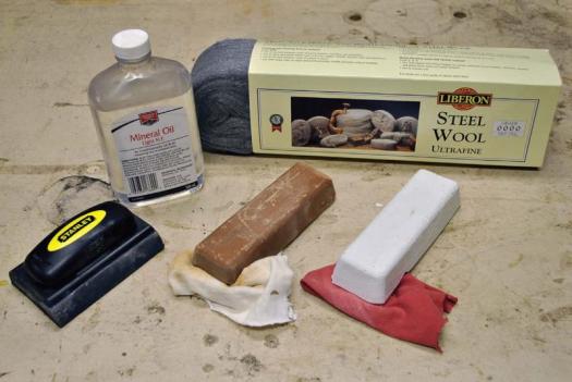

Buffing
 0000 Steel wool, mineral oil, an extra-fine sanding block and abrasive compounds will allow you to fine tune the amount of gloss the surface has.

To remove any imperfections, I use wet/dry sandpaper wrapped around a sanding block and lubricated with mineral oil. Before the second-to-last coat, I use 320-grit then I wipe the surface clean and apply a coat of finish. Then I sand with 400-grit before applying the final coat. Once the final coat has dried, some quick work with 600-grit should be enough to get a pristine surface.
Rub Out the Finish
At this stage your finish should be glossy and smooth. By buffing it with tripoli and white diamond compound applied to cotton rags or soft buffing wheels, you can slightly increase the gloss. Or, by scuffing the surface with 0000 steel wool and diffusing the reflected light, you can make the finish look almost as flat as unfinished wood. Should you rub through the finish, simply apply some more CA to that area and try again. Once you’ve achieved the sheen you like, you’re done. The best part about finishing with CA is that it is virtually maintenance-free – just keep it clean and it will continue to look as good as it did on day one.
