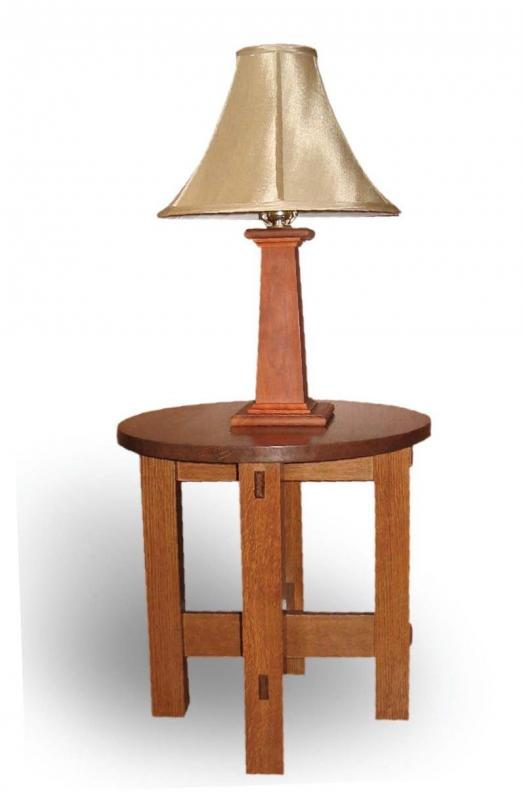

This small table is based on the Stickley #658 table from the 1912 Gustav Stickley Craftsman Furniture Catalogue. While it is often referred to as a child’s table, it will do just as nicely beside your favorite easy chair, or as a hall table.
To maintain the connection with the Stickley heritage, I made the table out of white oak, but cherry, walnut, or mahogany would look just as nice. The half lap and mortise and tenon joints are not overly difficult and will make for good practice for the novice and intermediate woodworker. I used 5/4″ stock for my material. If you choose to use 3/4″ stock you will have to make some adjustment to the dimensions in the materials list.
