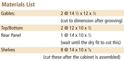

Sandpaper is essential in a shop, so it makes sense to have a cabinet to hold the paper close at hand. It’s a simple set of shelves, housed in a carcase made from Baltic birch plywood. Sandpaper is larger than writing paper – 11″ x 9″. One and a half inch Baltic plywood makes a solid carcase, and cuts cleanly on the table saw. The shelves are held in grooves cut with a single saw kerf. The rabbets were cut using a dado set and a sacrificial fence. The outside dimensions of the cabinet are 14-1/2″ high x 12″ deep x 10-1/2″ wide. This makes the openings 1/2″ deeper and wider than a sheet of sandpaper. The shelves are spaced at 1-1/2″ intervals.
Cut one large piece of plywood to make two gables at 14-1/2″ x 25″ x 1/2″, as it’s easier and safer to work with a single large piece of material than cut it in half after all the grooves have been machined. Set up the height of your saw blade for just short of 1/4″ above the table. If you go up to the full quarter-inch, the grooves will cut into your rabbets later. Once the cabinet is put together, we will determine the final width of the shelves.
Set up your fence to cut the first groove through the gable stock 1-1/2″ from the top of the gables. Increment the fence position by 1-1/2″, and cut the next groove. Keep moving the fence by 1-1/2″ until all eight grooves are cut in the gable stock. By keeping the stock as one large gable, and then cutting it in half later, we will have a perfect match with the slots, and the number of cuts made is reduced. Set your fence to 12″ and cut two gables from the grooved gable stock.
