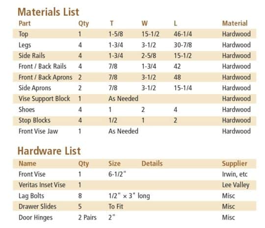

workbench materials list

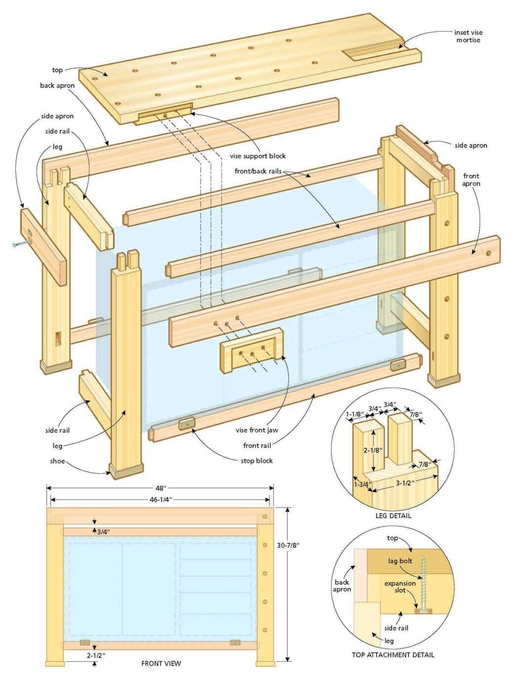

Create an Apron Notch
Duguay made two cuts on the table saw to create the large notch in the outer face of the legs. The front apron will eventually get glued to the resulting face of this notch, while the rear apron will be glued to the rear edge of the benchtop and be allowed to move with seasonal changes in humidity.

On this bench, the legs are flush with the front apron to aid with clamping. The benchtop is solidly fixed to the front of the base, and left to expand and contract at the rear of the bench. I made the leg assembly first, as it gave me an extra surface on which to build the top. While I milled the legs from 2″ by 4″ rough stock, you could also glue them up from virtually any thickness of stock. The tenons on the top of the legs (the left legs mirror the right legs) are quick to cut on the table saw if you use a tenon jig.
If you don’t want to cut mortises and tenons for the front and back rails you could use floating tenons, Dominos or dowels. I made the tenons 1/2″ × 1″ and 1″ long to maximize the gluing surface.
There is 4-3/4″ between the bottom of the benchtop and top of the cabinet, suf­ficient space to accommodate a holdfast or hold-down. The location of the rails isn’t crucial. I wanted to get as much cabi­net height as I could, so placed the top rails 3/4″ below the front and rear aprons and 2-1/2″ above the floor. The 3/4″ gap enables me to clamp objects to the bench top, though I get along nicely using bench dogs and hold-downs.
