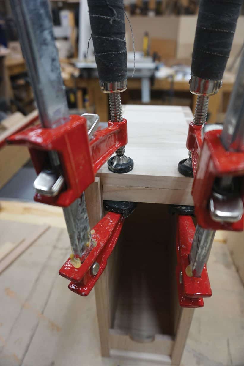

Dovetail joints
I start by dimensioning the two sides, top and bottom to 1/2″ thickness. I also mill some test pieces to help fine tune the dovetail joints. Then I lay out the dovetails on the dovetail jig and do a test cut. Once I’m happy with the fit, I cut the pins and tails on the box parts. I like using a dovetail jig, as once it’s set up the joints are cut quickly and efficiently without wasting any wood. You could eas­ily hand cut these dovetails if that’s what interests you. If you’re good with hand tools, hand-cut dovetails are very satisfying from both the maker’s and the user’s standpoint.
Front and back dadoes
Next, I cut the dadoes that will hold the sliding door on the left, right and bottom panels. I used a 1/4″ router bit to cut the 9/32″ groove in two passes. It’s easy to position the grooves in the top and bottom panel so they don’t exit at one of the pins, though the sides will need stopped grooves at both the top and bottom. You can accomplish this with a pair of stop blocks limiting travel of the side while you machine the groove that allows the sliding door to slide.
If you look carefully at the photo, you can see the front groove goes all the way through the side, which is a mistake. It should be a stopped dado at the bottom of the side. I plugged the hole at the bottom with a closely matching piece of wood. Because it’s on the underside of the wine box, I doubt anyone will ever notice.
Before assembly, the top of the box is cut along the front, allow­ing room for the sliding panel to be raised and lowered. After assembly, a piece of 3/4″ × 3/4″ wood is glued to the underside of the top between the sides and flush with its front edge of the top. This is the locking knob strip. Down the road, this piece will receive a 1/2″ diameter hole for the locking knob shaft.
Next, I made the front and rear panels. The grooves I machined are both 9/32″ wide to match with the plastic dispenser spout, but double check the spout you have. I pre-finished the back panel with one coat of wipe-on polyurethane before gluing it up.
