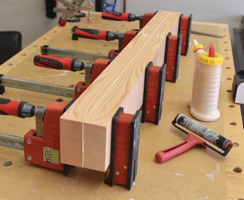

Face to Face
Nicholson glued two 2×4s face to face to create the main post.
Face to face

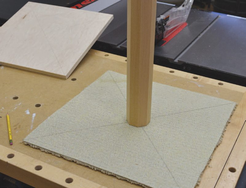

Make Room for the Post
Trace the post onto the carpet, then cut out the waste in the centre of the carpet. This will allow you to more securely attach the post to the base.

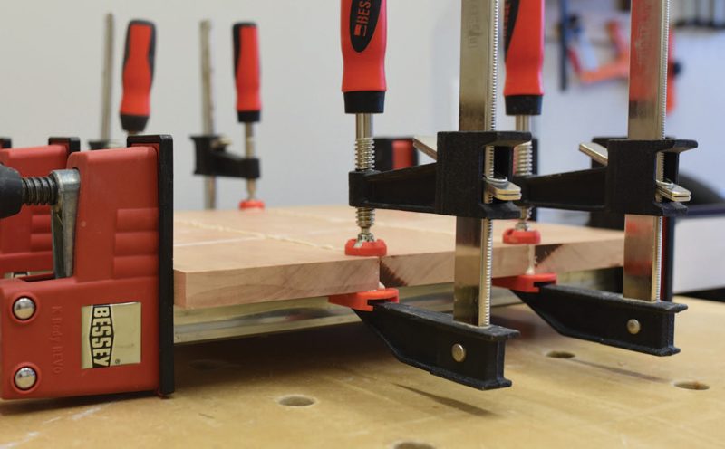

Simple Glue-Up
With the help of a few clamps to the keep the joints flush, Nicholson glues up the solid perch.
Simple Glue-Up

The core of the scratching post is made from a standard SPF 2×4. Begin by rough cutting two sections about 36″ long, and then flatten one face of each piece at the jointer. Apply wood glue to the machined surfaces and clamp the assembly up overnight. The next day, remove the clamps and rejoint one face and square one edge. Take the blank to the table saw and set the rip fence to 3″. Place one reference face against the fence and the other reference face on the table. Rip away the waste. Rotate the blank 90° and make a sec­ond rip cut. You should be left with a perfect 3″ square post. If your post is a little under 3″ to achieve a square, it won’t affect your final project.

Attach the post to the base
Flip your carpet upside down and centre the post on the carpet. Trace the octagon with a pencil and set the post aside. Cut away the carpet using your marks as a guide. Test to make sure your post will fit though the opening; adjust as necessary.
Centre the post on the plywood, using your lines from earlier, and drive four 2-1/2″ screws through the base and into the post. Make sure to predrill and coun­tersink your holes. Optionally, you can add some wood glue to the joint if you like.

Start by rough cutting, milling and gluing up a blank of hard­wood to a finished thickness of 3/4″. Be careful to get the edges of your blank aligned (cauls work well for this). If you choose to use biscuits, lay them out carefully so you don’t expose them in the next step. After letting your blank dry overnight, remove the clamps and scrape, plane or sand it flush.
