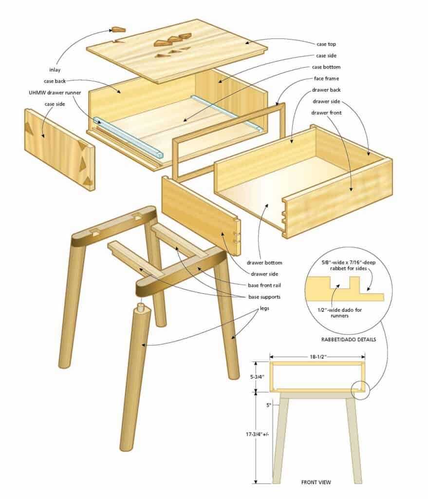

Table illo

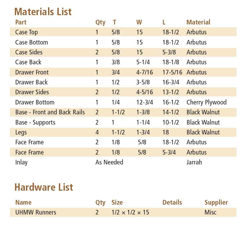

table material list

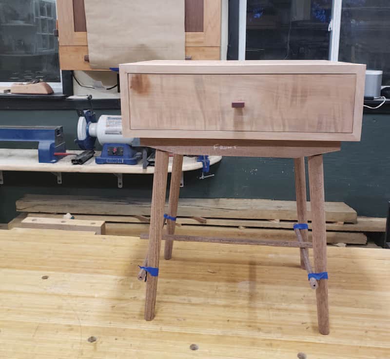

The Rejected Design
Bartley rejected this base design because it was far too busy.
bedside table
Base #2
The second version of the base involved making tapered legs the same width as the base. These could then be tapered and trimmed for a much cleaner overall look.
bedside table
Round Over
Once the parts were trimmed to size, Bartley rounded everything over with a trim router and then cleaned up the machine marks with a spokeshave and sandpaper.
bedside table
Base Joinery
A half-lap joint that doesn’t completely overlap the rails will offer strength for years to come.

Case joinery, construction and runners
There are many different approaches when selecting joints for the case, but I cut rabbets using a dado blade. The first step was to cut a rabbet the width of the case sides into the top and bottom panels. I then added a 1/4″ rabbet along the back of all four sides to accept a back. The sides of a bedside table will rarely, if ever, be seen and this method makes a square glue-up easy to achieve.
While I had the dado blade set up, I also added grooves for two UHMW plastic runners to sit in. I like using this low-friction plas­tic as it eliminates the need for any metal drawer hardware or unsightly grooves on the side of the drawer. This high molecular plastic is easy to work with and one or two passes of a hand plane creates a glass-smooth surface for the drawer to slide on.

Base
When it came time to design the legs for this table, I wanted something as simple and elegant as possible. The combination of the wild figure of the arbutus mixed with the triangle inlay defi­nitely meant I was running the risk of a very busy final product. I decided to use black walnut for the base for a few reasons. For one, I thought the darker colour would blend into the shadow below the piece and not become the focal point. Our hardwood floors are also stained a dark walnut colour. Finally, it allowed this piece to be in harmony with a few other pieces throughout the house that have a darker base with lighter top.
My initial plan was to turn the legs at the lathe and have them insert into a base assembly with 5° tapers cut on each end. To achieve this, I first cut the tapers in each end using a miter gauge at the table saw. Next, I tilted my drillpress table to the same 5° angle and drilled out a 1″ mortise using a forstner bit.
To finish off the base assembly, I added two structural cross pieces to hold the front and back together. These were attached by making a short (non-through) half-lap joint. The cross-piece joinery was cut at the table saw and the mating end of the joints were cut using a router and some light chisel work.
Back to the drawing board
After making all the pieces, dry fitting them together and setting the case on top I wasn’t at all happy with the way it looked. The transition between the square case, the angled base and the round legs was all wrong. I headed back to the drawing board to figure out a better plan.
About the only thing I liked about my first base attempt was the splay of the legs. After some head scratching, I decided I could keep the base assembly largely as it was. I could then create more integrated legs that when glued up and shaped would appear much sleeker and unified with the base assembly and the case.
Because I already had a round mortise in the base from the turned legs, I stuck with this method of joinery for attaching the new legs. Starting with square stock, I turned round tenons on each leg at the lathe.
At the table saw, using a shop-made tapering jig, I could then cut the legs down closer to their final shape. With the piece dry fit together, I then transferred the line of each leg up along the base so that I could remove the “horns” on each side remaining from my initial design. I marked a level line at the base of each leg so the piece would sit flat on the floor. I also removed a small amount of material from the front and back of the base assembly for a smooth transition between leg and base.
Once I glued the base assembly and legs together, I rounded over the leg assemblies using a 3/4″ round over bit. I then cleaned up the machine marks using a spokeshave and sandpaper.
