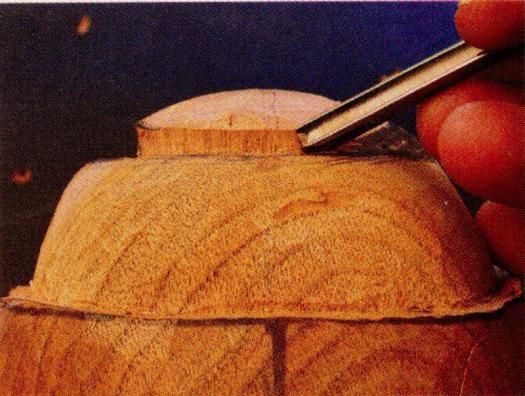

The thorax and the head are created using a parting tool (V-gouge) and a #2 gouge. Outline each section then round to create steps. Define the bottom of the oval head and undercut the thorax and body approximately 1″. Finally, make the split down the middle of the back with a parting tool. Your carving work is complete when you have thoroughly sanded the entire ladybug.

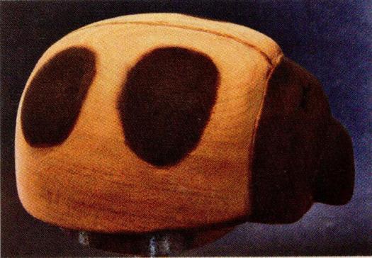

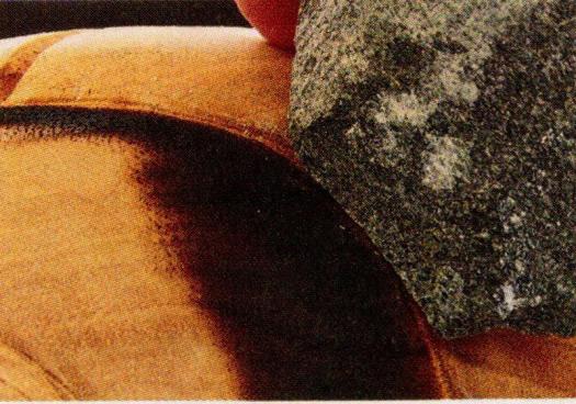

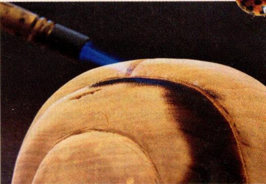

When I want part of a carving to be black, I usually use my torch. To practice the burning technique, begin with the head and thorax. Here’s a hint – use the torch like an airbrush, i.e. point the flame in toward the burnt area, not out toward the edge of the burn. To protect the areas I didn’t want to burn, I shaped a scrap of soapstone to use as a shield. Using the technique developed when burning the head and thorax, carefully burn the spots on the back. Other than the desire for symmetry, there is no rule for this step; burn as many spots as you like.
