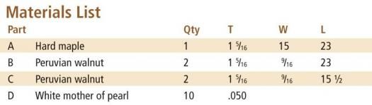

I purchased seven bdft of 2″ hard maple for this project. In hindsight, I should have purchased more because blemishes would appear when exposing large amounts of end-grain, and having more wood than necessary would have given me more choices when removing blemishes and orienting the grain. I also purchased the widest Peruvian walnut boards that I could find to laminate together to cut the 1 ⅜” edge strips with the grain oriented up and down. The chosen board yielded 5″ of width and, to make sure that I would have enough, I purchased a piece 5′ long. Approximately 10 sq in of mother of pearl was used.

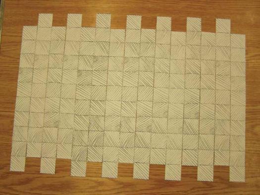

Keep things straight
 A paper pattern of the grain orientation will help when you are laying out the sections.

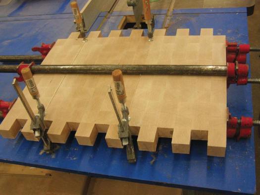

Glue it up
You shouldn’t need many clamps to bring the cutting surface together if care has been taken during the milling process.

Cut the finished strips into 30″ lengths. This is more than you need, but will give you options later. Laminate 10 strips together and remember to orient the end-grain appropriately. The extra piece allows you to stagger the grain pattern on final assembly. I used Titebond 3 for the glue-up. When the glue has dried, rip the lamination into 1 ⅜” strips across the lamination. This will give you ten 1 ¾” x 1 ½” by 1 ⅜” thick, end-grain pieces glued together.
Clean up the long-grain sides to prepare them for the next lamination. I used my vertical wide-belt sander, but any drum sander would work. Even taking very fine passes with the thickness planer works, although it just feels wrong to do this. Once the edges are true, laminate 15 strips together. This will make a piece approximately 23″ in length. Remember to offset the ends of the pieces to enhance the grain pattern of the cutting surface. Allow to dry and then carefully sand the cutting board blank to 1 ¼” in thickness.

While waiting for glue to dry, I surface the Peruvian walnut board. Mine finished to 5″ wide and I planed it to ⅝” and then sanded it to 9/16″ thick. Cut ten 5″ long pieces. Assemble two pieces 5″ wide by 26″ long and be sure to glue long-grain to long-grain. When the glue has dried, carefully sand the pieces with a palm sander and be sure both sides are clean. Now you can rip 1 5/16″ strips off of the end. This will yield a bit more than you need, but you should have six 1 5/16″ wide by 26″ long pieces, four of which will be needed for the border.

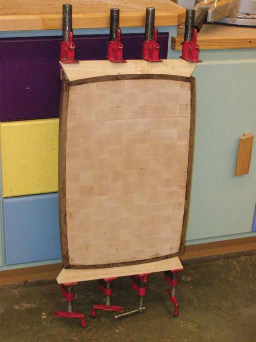

Attaching the Border
Once the maple cutting surface is in its final form, mark the edges on some 2″ pine and cut four clamping cauls that perfectly match the curved contours. Using the clamping cauls, carefully test-fit the walnut border one piece at a time. Carefully mark the corners. Because of the curve of the board, these mitres are not 45° angles. I custom cut each corner. In this case, the actual setting on my mitre saw was approximately 36°, but this will vary depending on how much curve you put on your cutting board. Carefully fit all sides of the border and make sure all the mitres fit tightly. Do a ‘dry fit’ test run and, if it all fits well, glue the border on with Titebond 3.
The clamping cauls should ensure a good glue joint.
