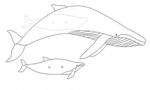

Transfer the pattern onto tracing paper, making sure you include the grain direction and the lines on the “throat grooves,” tracing paper will allow you to see the wood grain when laying out the pieces. Select the piece for the adult whale’s body.
Note: If you don’t have a piece of walnut wide enough, glue up two pieces to attain the necessary width.
Using the traced pattern and transfer paper, mark and cut the piece to shape.
Sand the edges with an oscillating spindle sander or drum sander in a drill press, to ensure the edges are square.
Always remove the burr from the back of each piece as they are cut, this allows each piece to sit flat and square, a bow sander works great for this.
Select the wood for the next piece, slide transfer paper under the pattern and place the first piece in position. Mark the piece using the pattern and the edge of the first piece as a guide. Cut and fit.
When you are happy with the fit, then tape the piece in position with duct tape. Continue marking, cutting, fitting and taping until all the parts are done.

Cut the segments on the throat ridges using a #5 (or smaller) blade. Cut to within ⅛” of the edge.
Note: not sawing the pieces completely apart allows you to shape the throat grooves as a unit.
