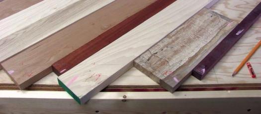

Looking Good
Working directly on her workbench, White laid out the dressed boards in a way that was visually appealing to her. Once she was happy with the results she marked the boards.

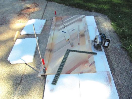

A Quick Trim
A track saw, or in this case, a long straight-edge and circular saw, makes quick work of truing the jagged edge left after glue-up is complete.

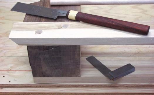

Three Rabbets
Each leg was rabbeted on three faces, to accept the mating rails.

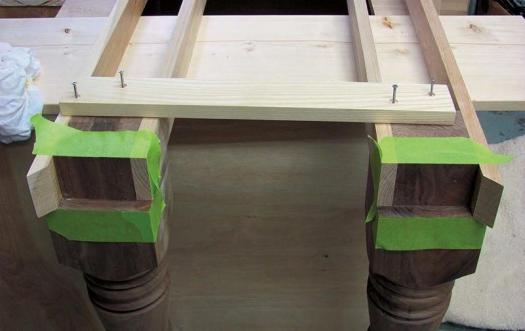

Inner Short Rail
With tape to protect against squeeze-out in place, the inner short rails brought the two sub-assemblies together for good. Screws and glue created a solid joint.

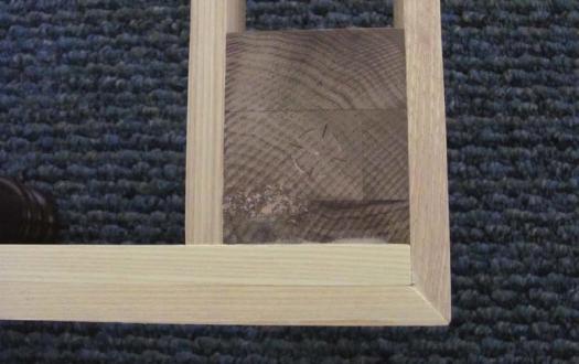

Finished Joint
The top view of a leg joint, showing how the short and long rails mate with the leg.

Now I had to choose woods. For cost reasons, I decided I’d use as much as I could from my stash, but within those limitations, I wanted as much variety in colour and texture as possible. I had received my beautiful turned legs (more on them shortly) and they were walnut, so I definitely wanted a little walnut in the top. At home I had one board of cherry, one of walnut, one of poplar, lots of hickory and ash, and several little pieces of exotics. Then I spied some bits of spalted maple I had been saving that had come from my backyard. This spalted maple instantly became a must-have for this table. That was my first mistake, as you’ll see later.

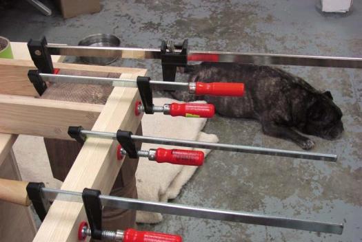

One tricky glue-up
Glue-up started off straight-forward and then became more and more difficult because of clamping. I started with gluing two boards together, then four boards together, etc. Clamping was fine in the beginning, but the more boards I glued together the harder the clamping became because the boards were at an angle, and they wanted to slide back and forth. It is impor­tant to clamp across the seam between two boards. The more boards you are clamping at an angle, the harder it is to do it across the seam without the boards sliding. If you don’t precut the edges at the 45° angle, then you have “wings” on each side to help with clamping. I made a little jig for holding the square edge and clamping across. And remember that, when clamp­ing anything long, you need long clamps. I had four long pipe clamps and wished I’d had more.

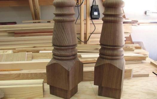

I wanted turned legs for the base, but I don’t have a lathe, or the skills to produce them. No problem. The walnut turned legs were made by Osborne Wood Products to the exact dimensions and style I was after. This allowed me to create a table that would have otherwise been impossible. My main pre­occupation at this point was to not mess up the legs because they were beautiful. I spent a lot of sleepless nights worrying about those legs. I hated to cut into them but I knew I’d have to sooner or later. Since I’m a novice, I decided use very simple joinery. I used eight rails to tie the four legs together: four long rails and four short rails. The rails sit in rabbets cut into the tops of the legs where I have the rails glued and pinned (for the long rails) and glued and screwed (for the short rails). I used wood pins where they would be visible and screws were they wouldn’t be seen.

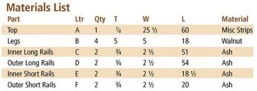

Since my rails were all 2-1/2″ wide and 3/4″ thick, I made three rabbets on each square leg top that were 2-1/2″ wide and 3/4″ thick. My exterior long and short rails have a mitred end so that they meet neatly and the structure under the table looks finished. I cut those small mitres on the skinny rails with a mitre box and was pleasantly surprised at its accuracy.
Rabbeting the leg tops was nerve wracking, to put it mildly, especially after I messed up the first rabbet on the first leg while trying to cut the rabbet with a dado stack. Since the legs were turned, and they tapered down toward the foot, it was almost impossible to lay the legs against a fence and hold them steady. There are a lot of ways to cut rabbets, including a hand-saw or hand-plane, neither of which I can manage well, so I finally decided to cut them on the table-saw with a regular blade, hold­ing the leg upside down and vertical, and run them through the table-saw very carefully. I did have to make a small cut with a cross cut sled to finish the rabbet, but again, I was very careful.

With the long rails cut to size (half of them with their ends mitred), I assembled two sub-assemblies, each of which con­sisted of two legs and two long rails. I glued the rails to the rabbets in the top of the legs, then added the wood pins. When they were dry, I flushed the pins to the rails surface. The inner long rail was fairly easy to position on the leg; its ends fin­ished flush with the end face of the leg. The outer long rail was harder to position, but with some patience and planning every­thing worked out nicely.
With the two sub-assemblies lined up side-by-side, I attached the inner short rails to the rabbets in the legs with glue and screws. I then attached the outer short rails, which were glued and clamped over the inner short rails. Holes were then drilled through the inner and outer long rails, into the legs, and wood pegs were glued in place. Once dry, the pegs were cut flush.
