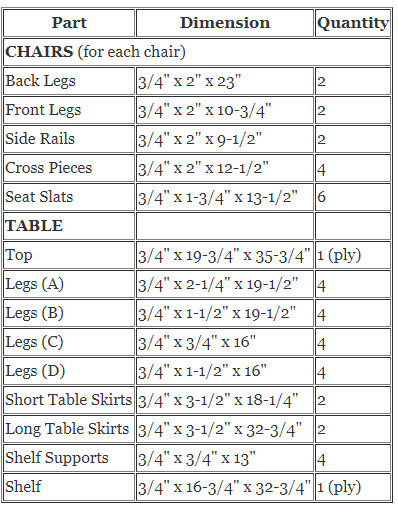

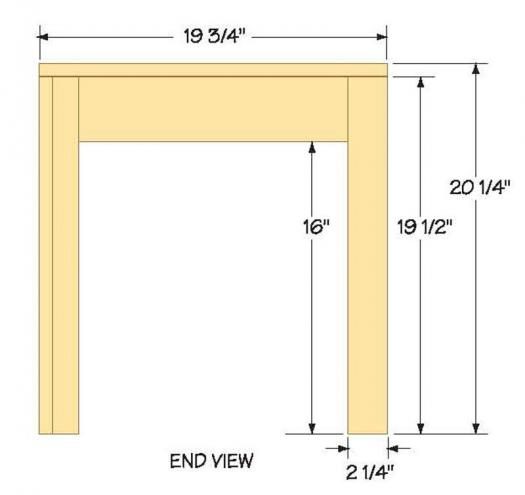

Cut Leg Pieces
For the legs, cut the pieces to size according to the materials list, and smooth the edge with a sanding block or hand plane.
Assemble And Glue
Assemble and glue the leg pieces together. To ensure the correct offset between the short and long pieces, use a scrap piece of 3-1/2″ board as a guide. It may be easier to glue the leg pieces together one at a time, waiting for each one to dry before adding the next.

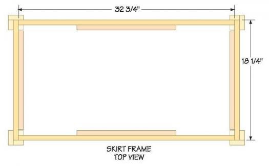

Drill Pilot Holes
Drill countersunk pilot holes in the ends and middle of each ledge piece and screw them to the inside of the table skirt pieces so that they are flush with the bottom and centered from end to end.
Drill countersunk pilot holes in the skirt end pieces 1/2″ from the ends and 1/2″ from the top and bottom edges.
Apply Glue
Apply glue to the mating surfaces and screw the skirts to the leg pieces from the inside so that they are flush with the top and butting up against the leg piece.
Drill Pilot Holes
Drill countersunk pilot holes in the front and back skirt pieces 3/8″ from the ends and 1/2″ from the top and bottom edges.
Apply Glue
Apply glue to the mating surfaces and screw the skirts to the leg pieces from the inside flush with the top and butting up against the end skirt pieces.
Insert the bottom of the table into the frame (made by the table skirts) and screw it in place from below through the ledge with one screw on each side.

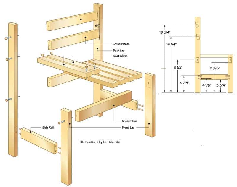

Chair
On its own or as a companion to the kids table, this chair is sturdy and easy to build.
Round Edges
Lightly round all corners and edges with a piece of folded #180 sandpaper.
Drill Dowel Holes
Drill the dowel holes in the side rails as shown.
Drill Matching Holes
Drill matching holes in the front and back legs.
Apply Glue
Apply glue to the dowels and insert them into the side rails, then apply glue to the end of the side rails and assemble the front and back legs and the side rails together to make the chair sides. Clamp the assembly together, making sure the legs are parallel and square to the side rail.
Drill Pilot Holes
Once dry, drill counterbored pilot holes in each chair side for the cross pieces.
Glue and Screw
Apply glue and screw the two cross pieces that support seat slats.
Drill Pilot Holes
Drill one countersunk pilot hole about 1″ from each end of the seat slats.
Apply Glue
Apply glue to the mating surfaces and screw the seat slats to the cross pieces so that the slats are flush with the front and evenly spaced.
Apply glue to the mating surfaces and screw the cross pieces for the seat back in place at the angle shown.
Glue flat screw hole plugs in place.
Option: Instead of using dowels for the side rails, drill deep counterbored pilot holes and screw the pieces together.
Tip: Drill 1/8” pilot holes in the center of the ends of each cross piece for easy alignment when screwing them in place.

    1. Some of our very early articles (and that one is 17 years old) don’t have material lists. You’ll need to use the illustrations to cobble together your own list David.
