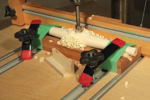

To drill the mortise holes in the stretchers, a simple V-block is required. To keep this specific stretcher from rocking, two small V-blocks support either end of the stretcher during drilling.

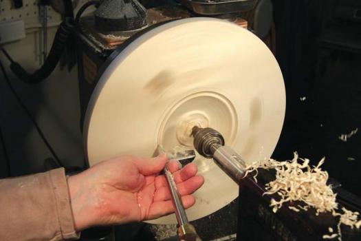

With the seat re-mounted on the lathe, remove as much evidence of its initial mounting as possible, then finish sand the area.

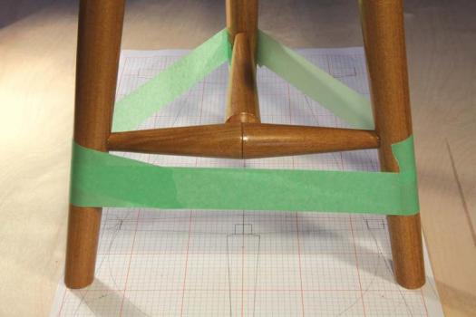

Once epoxy has been added to the mortises and tenons, assemble the parts and use tape to hold everything in place while the epoxy cures.

With the stretcher cradled in a shop-made V-block, 12″ x 4″ x 1-1/4″ with little Vs leveling the ends, center the stretcher on the Forstner bit, set the drill-press to slow, set its depth stop, and bore a 3/4″ x 3/4″ mortise.

Back at your lathe, turn out and finish-sand the center under the seat, removing evidence of its initial mounting.

Once the finish has cured, do a complete dry assembly, with the seat inverted on your bench. Follow this with final assembly, using G2 epoxy or equivalent, applying a thin coat to both parts of each joint. Assemble the stretcher/stringer firmly first. Next, carefully insert this assembly into each of the three legs while they are loosely perched within the lip of the seat mortises. With all components loosely inserted, draw the legs together fully onto the stretcher/stringer while firmly pressing/wiggling the legs into the seat. Taut strips of tape stretched from leg to leg will hold them together nicely. Now invert the stool onto its feet on a flat surface and weigh down the seat until the epoxy cures.
