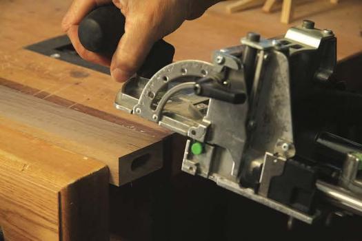

Quick Mortises
The Domino DF 700 makes quick work of mortises. Brown ganged together three legs to offer a larger surface for his machine's fence to reference from.

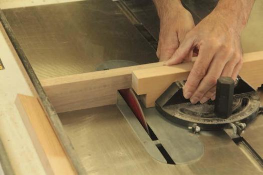

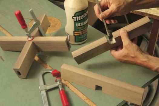

Half Lap
Brown uses his rip fence as a stop to determine the width of the half lap joints in the cross rails.
Cross Rail Assemblies
Once the cross rails are sanded, apply glue to the face grain in the joint and bring the mating parts together with a clamp.

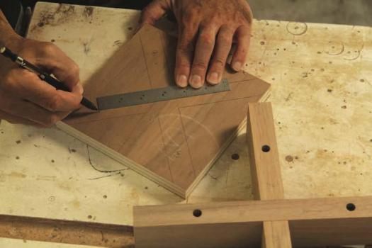

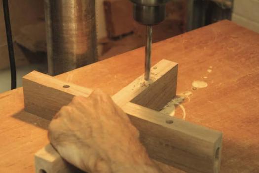

Dowel Holes
1/2"-deep x 3/8"-diameter dowel holes are marked and drilled in the upper cross rail assembly.
Transfer Hole Locations
With the cross rail assembly to guide you, mark the location of the dowel holes in the plywood light support and drill the holes.

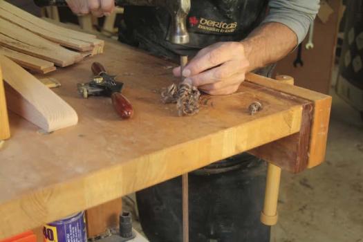

Form a Dowel
Although it's covered by the wood shavings in this image, a dowel former is a great way to obtain dowel rods of almost any length, in almost any species.

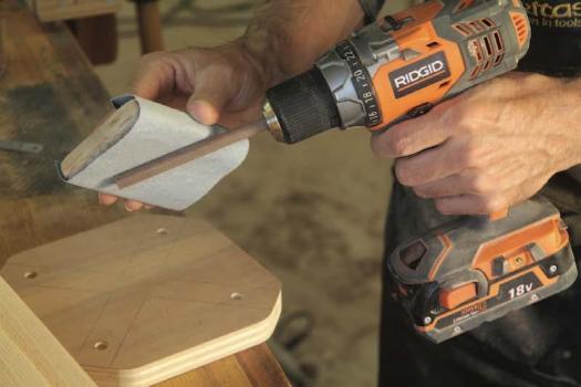

An Easy Sand
Chuck a 5"-long section of dowel into your cordless drill, pull the trigger and sand the dowel. Notice the final shape of the plywood light support in the background.

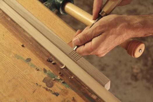

Add Texture
A small, sharp carving gouge makes quick work of adding texture near the tops of the legs.

After breaking them out and machining them to final dimension, you need to consider joinery. If you taper the legs too soon it may be difficult to machine straight, right-angle joints. I set up my Domino DF 700 with a 12mm cutter, marked the locations of the upper and lower joints, then cut a total of eight Domino slots in the backs of the legs. I ganged three legs together and put them in my vise while cutting the slots, as the extra thickness gave the Domino’s fence something to reference from. Be very careful not to cut right through the outer face of the leg. I went within about 3mm of doing so, as I wanted to create a deep mortise in the leg for a secure joint. I wouldn’t go any closer though, unless I had an extra black walnut board on my shelf that was just wasting space.

Simple half lap joints secure the rails to each other. I cut those on a table saw with a mitre gauge. I set up my fence as a stop, adjusted the blade height to cut close to half the width of the part, then made a few test cuts. Before making the cuts, I made sure the resulting half lap wouldn’t be too wide or too deep. After a few adjustments I was ready to make the cuts in all four cross rails. I aimed for a joint that was very much on the tight side, as once the parts were sanded they would fit together nicely.
After sanding the rails, and ensuring a perfect fit, I applied glue to the joints and brought the two halves together with clamps.

I drilled the 1/2″-deep dowel holes in the upper cross rail assembly, then transferred their locations to the plywood light support and drilled them. With the light cord on hand I was able to drill a properly sized hole in the light support.
I made the dowels with a dowel former, though you could purchase a length of dowel if you wanted to. I wanted to match the walnut wood of the rest of the lamp. The dowels are each 5″ long, so I made one length 25″ long and cut it into four pieces.
Texture on the legs
I love the look and feel of textured wood. Not wanting to go overboard, I used a small gouge to add horizontal grooves in the outer face and both sides of each leg. The grooved band was 1″ wide and started 3″ below the top of the leg. Walnut is fairly easy to carve, but even all but the densest woods aren’t too hard to work with when it comes to this type of texture.

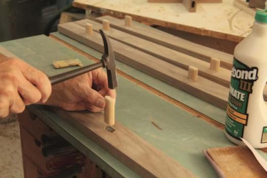

Glue the dowels to the upper rail assembly, then add some glue to the dowel holes in the light support and bring it into position.
