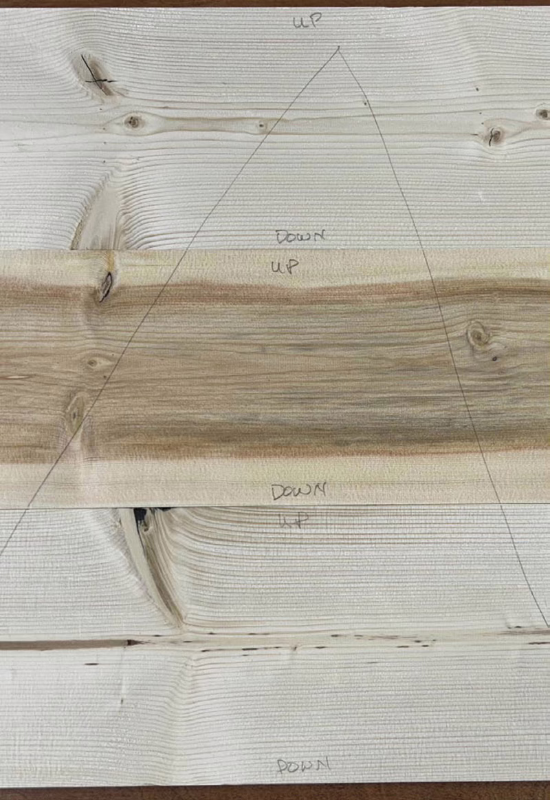

Mark Them Up
Adding a cabinetmaker’s triangle on the boards, or even just numbering and labelling them, will help you reassemble the individual boards into panels in the best looking way.
Mark Them Up

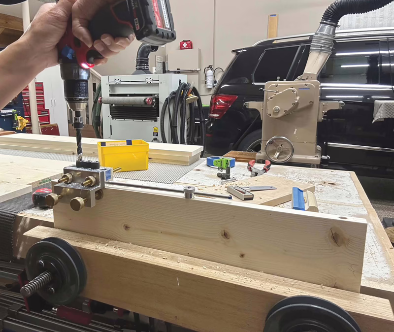

Drill Dowel Holes
Takeda uses his Dowelmax jig to help him bore the holes in the ends of the sides, as well as the inner faces of the front and back. When boring the mating holes in the front and back (right), make sure not to drill the holes so deep that they exit the visible face of the panels. A stop collar on your drill bit will assist with that.
Drill Dowel Holes

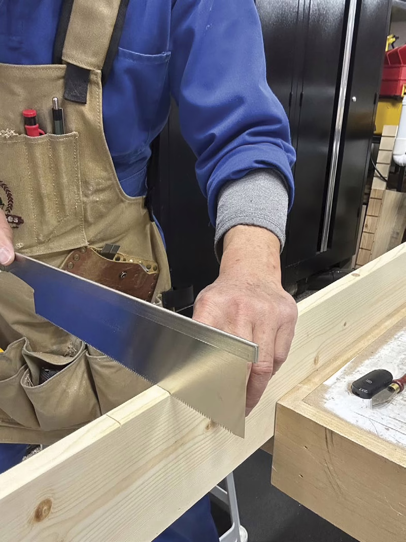

Install the Hinges
Takeda locates the hinge, then scores the fibres of the wood on either edge of the leaf. He can then use that mark to help him create the mortise for each hinge.
Install the Hinges
Form the Mortise Sides
Takeda uses the scored lines to help him position his hand saw, which he uses to further form the sides of the hinge mortises.

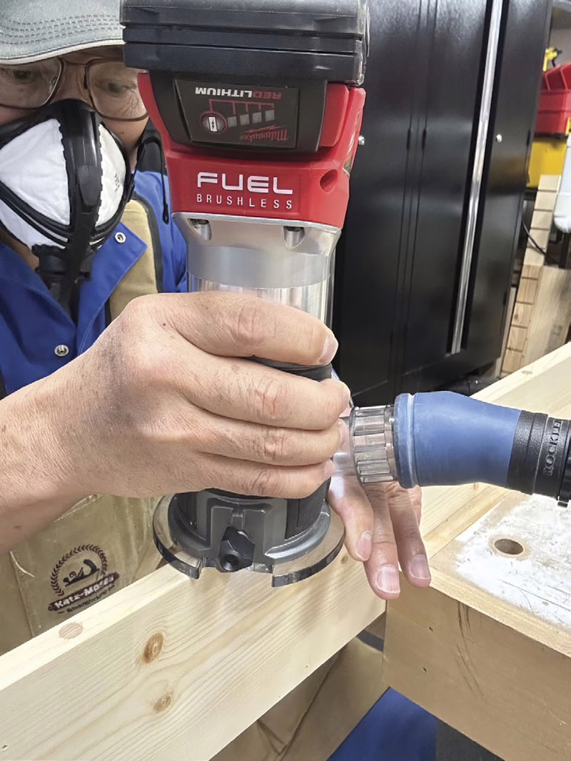

Remove the Waste
With the hinge mortise sides created, a trim router, equipped with a straight bit, will help remove the rest of the material. Clamping a piece of scrap wood on a face of the workpiece, with its edge flush with the edge of the workpiece, will give you something to help steady the router during this operation.
Remove the Waste

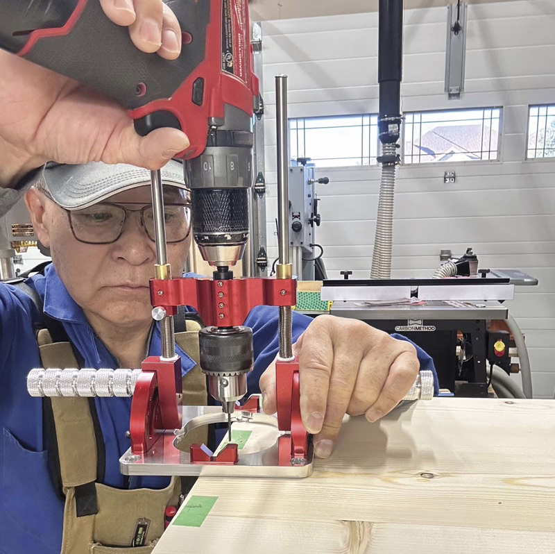

Rope Handle Holes
Drill two holes in each side of the assembled project to accept the ends of the rope handle. Takeda first drilled from the outer face towards the inner face, and used a scrap to help him determine when the centre spur of the drill bit was about to protrude through the inner surface. At that point, he drilled from the inside out, which eliminates blowout.
Rope Handle Holes

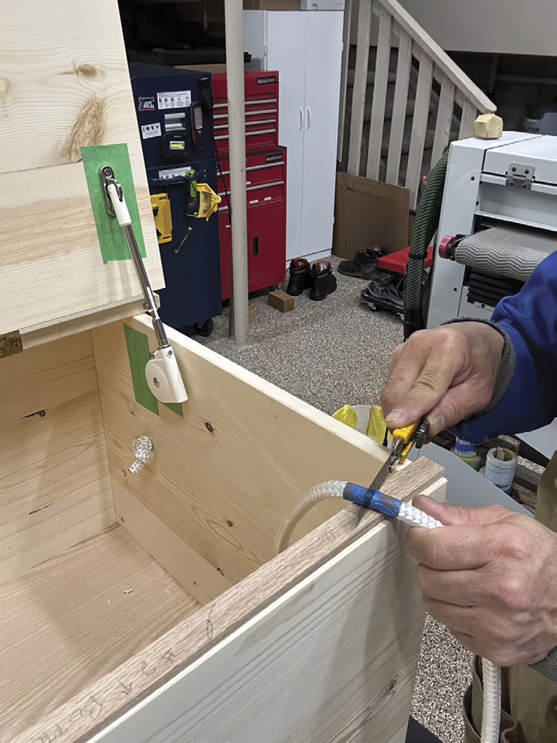

Tape, Then Cut
Takeda applies tape to the rope where it needs to be cut to length, then uses an open flame to melt the ends to keep them from fraying.
tape then cut

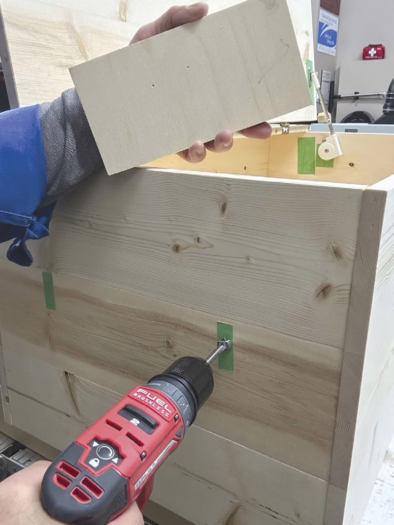

Straight Pilot Holes
If you choose to add the decorative GRK screws to the corner joints, ensure to drill a straight pilot hole so the screws don’t blow out the sides of the panel or split the panel.

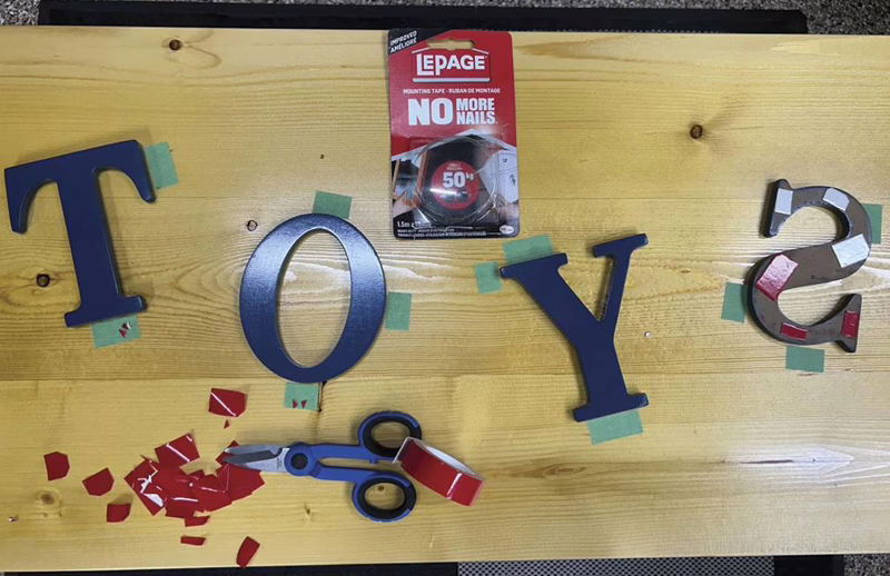

Add the Letters
Letters can be applied to the finished box with double-sided tape. You could also screw them on from behind or scrape off some of the finish directly behind the letters and use some adhesive.
Add the Letters

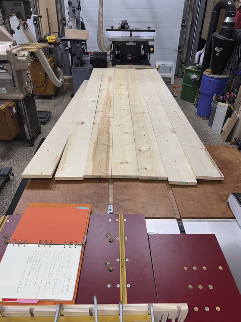

Panel assembly
Trimming the board edges for the box and lid panels came next. I arranged the 10 38″ boards to best highlight the lid and front panel. Any defects in the boards were hidden on the inside of the box, where pos­sible, so I didn’t have to mill all the defects out, thereby keeping the boards as thick as possible. Next, I drew a triangle on each panel and took pictures to aid in keeping the same position of each board through glue-up. I also wrote on opposing edges of each board alternating the word “up” or “down” to indicate which way the board would be final-trimmed. By alternating the face of the boards up and down on the table saw, any discrepancy in the blade being square to the table is negated when the boards are glued and the joints appear seamless.
Before gluing the boards, I used 3/8″ × 1-1/2″ diameter dowels to aid in edge align­ment. The dowels don’t add any strength to the joint unless you have a poorly fitting joint. My Dowelmax jig has served me well for a decade. Like any tool, a learning curve is required but the reduced stress when gluing is worth it to me. Other dowel jigs, or even dowel centres, could also be used.
Three dowels per joint were used on the shorter side panel boards and five dowels were used on the front, back and lid boards. Locate the dowels so they remain hidden in the panel, rather than become vis­ible when the panel ends are trimmed to length after glue-up.

Drill dowel joints
Once the individual panels were glued up, I trimmed the ends of each panel to width, taking into account any flaws that could be cut off. I then drilled more 3/8″ diam­eter dowel holes on the ends of the side panels and on the face of the mating front and back panels. These were drilled so they wouldn’t protrude past the outer faces of the front and back panels, yet would collectively accept a 1-1/2″ long dowel. These dow­els ensured the corner joints would be easy to position in the rush to glue and clamp the box square, as well as keep the corners secure for a long time. Just be sure not to bore the holes in the front and back panels so deep they protrude out the show face of the workpiece.

Once the clamps are removed, the back board for the lid needs two brass hinges installed. I used a high-quality pair of hinges from Lee Valley, but this lid would function just as well with a much simpler and more cost-effective butt hinge. With the lid in place, I used a pencil to mark the location of the hinges on painter’s tape so there was no chance the pencil marks would remain on the wood, as all surfaces are mostly sanded. A marking knife cut next to the edge of the hinge makes it eas­ier to use a pull saw to cut the depth of the hinge plate. I then used a trim router with a straight bit to remove most of the waste, then cleaned it up with a chisel.
Use a downcut spiral bit in a router to remove most of the waste, then use a chisel to clean up to the saw line. Drill all hinge screw holes with a self-centring bit.
Drill 1/2″ diameter holes on the sides with a Forstner bit to anchor white nylon rope for the handles. To prevent tear-out as the Forstner bit drilled through, I held a scrap board on the inside and stopped drill­ing when I could feel the centre point contact the scrap board. You can also stop drilling to check on your depth. I then drilled from the inside out to complete the hole.
I also used a 1/8″ round over bit in the holes to ease the edges to reduce stress on the rope and to avoid splintering. To pre­vent the end of the rope from fraying when cutting the rope, place a piece of painter’s tape snuggly on the cut line and cut through the tape. Use a small flame to melt the ends of the rope before removing the tape.

For some added visual detail, I included brass-coloured GRK low profile #8 × 1-1/2″ long screws in the box corners and to secure the top lid board. I don’t think the box corners need the screws for strength, but it doesn’t hurt. I predrilled the holes with a drill jig to ensure I didn’t angle the hole and have a screw blow out the side. A final sand­ing with the Festool edge sander to clean up marks left from the trim bit bearing, and a quick hand sanding with the grain to remove any clamp marks, sharp edges or scratches will prep the project for a finish.

Add letters
The 5″ MDF letters on the box were ordered from Amazon, though there’s always the option of making your own from plywood, MDF or solid wood. I sanded the letters and brushed on Target Coatings HSF5000 surface filler before re-sanding and spraying on three coats of blue enamel paint. I attached the letters to the box front using LePage No More Nails double-sided tape for a permanent fix. I first arranged the letters, then used painter’s tape to mark the location of each letter, then applied the double-sided tape to the back of each letter and repositioned them on the box.
When the finish had cured, I applied a coat of Renaissance paste wax to the outside of the box (after the letters were attached) with #0000 steel wool to improve the appearance and provide a bit of pro­tection. I didn’t apply wax to the inside to avoid residual odor.

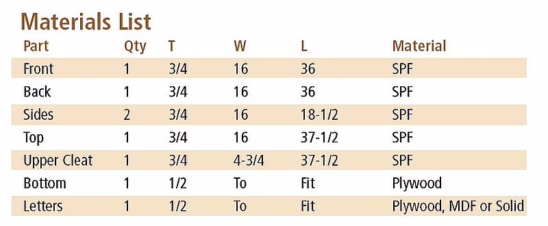

toy box material list
Toy box hardware list
