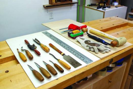

Determining where to locate each tool is an important step. Generally speaking, a project like this needs to be as small as possible, though it’s just as important to be able to hold all the necessary tools in one toolbox. Der-Garabedian lays out the tools on a piece of material and records how much space is needed.

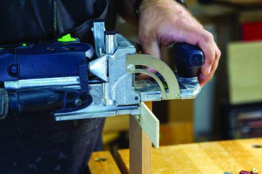

Dominos, with a Shim
 Even on its shallowest setting, the Domino mortises would protrude out the other face of the workpiece. Der-Garabedian adds a shim between the cutter and the workpiece to save the day.

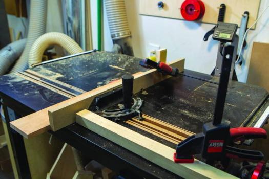

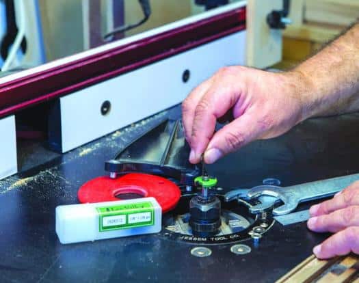

Slot Cutter
To cut the slots in the inside face of the carcass to accept the back panel, Der-Garabedian installs a slot-cutting bit in his router table and makes a few passes at different bit heights. Bearings of different diameters will give you some flexibility, as they all leave grooves of different depths.
Nice Grooves
 The router table provides a large, flat surface to support the dry-assembled carcass while the joinery to accept the back is machined. Multiple passes allow you to customize the grooves to accept any back thickness.

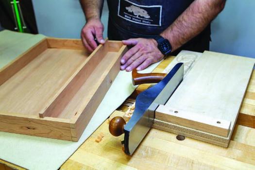

Trim to Length
Der-Garabedian uses a hand plane and jig to ever so slightly trim the interior parts to length, one pass at a time. The benefit of using hand tools for this is that it’s much easier to arrive at the correct length, and only very rarely do you end up with a workpiece that’s cut too short.

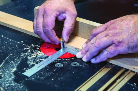

Where’s the Cut?
 In order to mark the edge of the spiral router bit, Der-Garabedian rotates the bit while placing a small square against the workpiece and bit. When the square moves to its furthest point away from the center of the bit, he knows that’s the outer limit of the cutting circle, and he marks the location on the mitre gauge for future use.

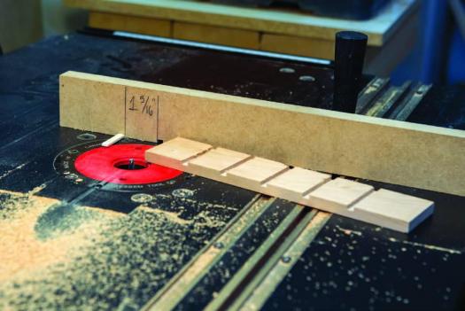

Simple Spacing Jig
To make a jig to cut evenly spaced dadoes, make a notch in a piece of MDF with the bit you’ll use for the dadoes, then glue a strip of solid wood into that slot that fits the notch snugly. Next, move the piece of MDF to one side by the width of gap you want, plus the width of the dado you’re cutting.

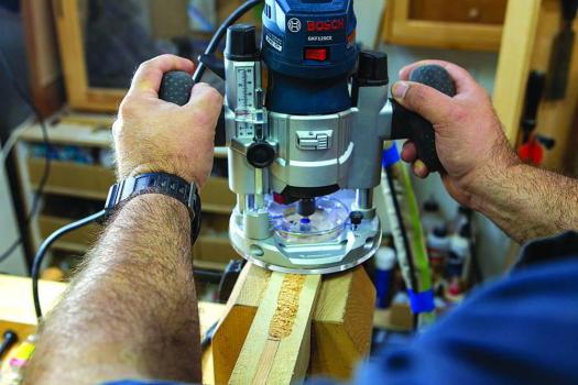

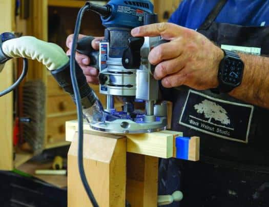

Balancing Act

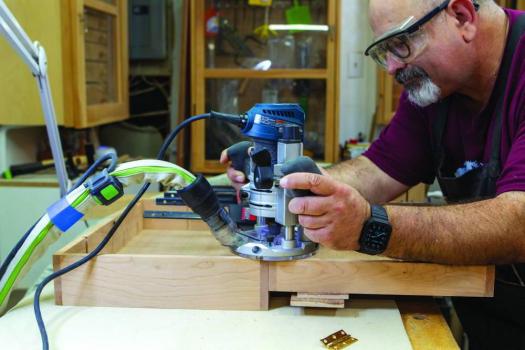

 Routing the rail and flip-stop slots in the top of dividers is easily accomplished with a hand-held router. Der-Garabedian adds thicker sacrificial pieces on both sides to aid not only in balancing, but also to prevent tear-out.

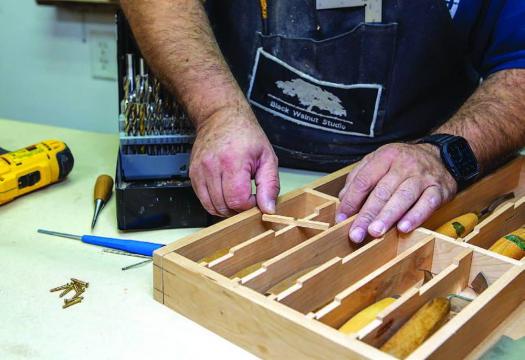

Snug But Not Tight
Der-Garabedian adds the flip-stops to the dividers by first drilling a pilot hole through the pair, then a clearance hole through the flip-stop and finally countersinking for a flat-head screw.

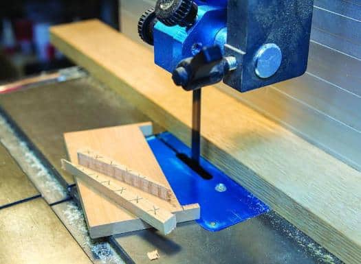

Door Relief
The band saw is a safe and simple way of relieving the top of the divider for the door compartment.  Cleanup can be accomplished with a file and sandpaper.

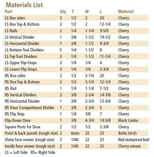

Keeping things light, I chose 1/2″ thick walls for the carcass, made the larger dividers 3/8″ thick and the smaller tool dividers 1/4″ thick. Joinery was kept simple, with slots and grooves cut on the router table. For the carcass joinery, I chose a pair of 4mm × 20mm Festool Dominos in each corner of the smaller left half and 6mm × 40mm Dominos for the bigger right side. Other joints, such as dowels or mortise and tenons, would work equally well on the box corners. Use the method that you’re comfortable with and have the tools for.

It’s much easier to design a box with a specific purpose by using the actual contents you plan to store to determine the size. Try dif­ferent positions for tools or group the ones used together. When laying out the tools on your workbench, keep in mind that the back panels will need to be added to the overall depth. Take your time with this stage as the dimensions will be determined by this step. I grouped the thinner tools on the left side of the box and the bulkier, odd-shaped items on the right. For added accuracy, mill up pieces of scrap wood to size and confirm that everything fits. The final dimensions ended up being 13-1/4″ wide × 20″ long. The box is 2″ deep on the left and 3-1/4″ on the right.

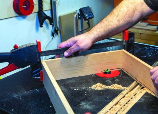

We’ll need to create a groove for the panels at the bottom of each half. A sim­ple method I’ve been using for some time now is with a box slotting bit 16J8312 available from Lee Valley Tools. This bit cuts a 1/8″ thick groove and comes with two bearings allowing for different depths of cut. Put the smaller of the two bearings on the bit for a 5/16″ deep groove.
In order to size the slots we need to know the final thickness of our panels. Clean up both faces of the panels with sandpaper, keeping in mind we have only so much veneer to work with. I like to do an initial pass with a random orbit sander at 180x, then switch to scraping and hand sanding to tackle any remaining spots.

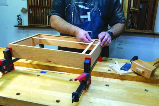

Dry assemble the left half of your box using clamps, making sure everything is flush. Raise the bit so it will cut a groove 1/8″ from the bottom. Get a scrap piece of wood and run a groove in it. We’ll use this to hone in on the perfect fit. Next, set your box on the router table and run the bit counterclockwise along the inside. Raise the bit slightly and run the test piece against the bit. Try and fit the panel into this groove. Chances are it’s  still under­sized. Run the box around the bit again. Go back and forth between the test piece, the panel and the box until you get a nice fit. While a tight fit might be tempting, you don’t want to risk breaking the lip and you’ll need room for glue. Repeat these steps once more for the other half of the toolbox.

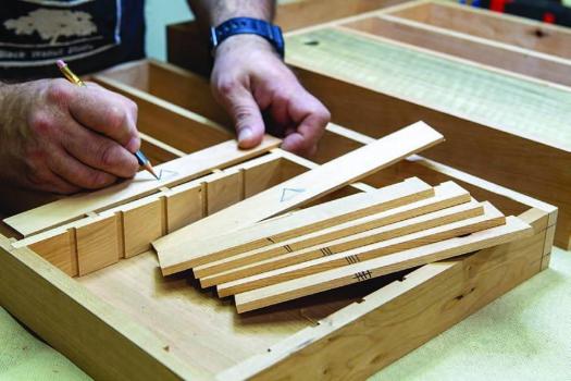

Use story sticks to measure the length and width of the panels directly. It’s easy to make them from scraps of wood by re-sawing a 1/8″ thick piece that’s approximately 3/4″ wide and longer than the box is wide. Using a chisel, put points on both ends and start fitting it into the groove. Trim a bit off of the points, going back and forth until the story stick is parallel to the ends and fits in the groove. Repeat these steps for the length of the panel. Set up your cuts on the table saw using these sticks. Since the box slotting bit leaves rounded corners, we can either square the grooves or round the panel corners. I find the latter much easier, using a washer or an offset wheel gauge that matches the bit diam­eter along with a chisel and file.

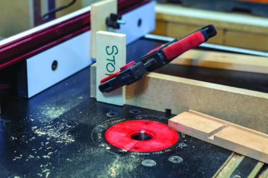

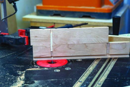

Work on one half of the box and one section of each box at a time to avoid any confusion. Similar to a box slotting jig on the table saw, we will set up the router table to cut matching slots in our components. Some of these will be through cuts while others will need to be stopped. It’s very important during this process to keep track of the orientation of the pieces. Using the following steps, we will cut the slots in our box frame and the thicker dividers. Position and space these to accommodate your tools.

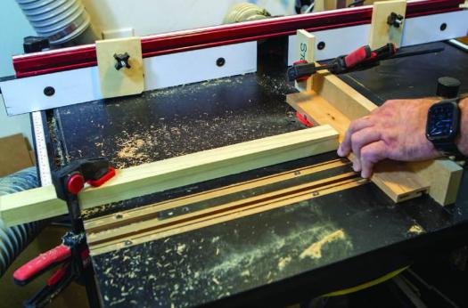

Add an auxiliary fence to the mitre guide and make sure it is locked at 90°. Chuck in a 3/8″ straight bit and, if you have it, a 3/8″ onsrud up-cut spiral bit, which will work nicely to pull the waste down and out of the slot. Make yourself a non-slip, shop-made stop block by adhering sandpaper onto the back.
Raise the router bit to 1/4″ and cut the slot in the auxiliary fence. Next, space and clamp the stop block the distance required for the pocket, in this case 2-1/2″. We need to stop this slot at the groove for the panel. This is easily accomplished using a long piece of wood clamped to the left edge of the table, stopping us from sliding further into the bit than the groove. For the mating piece, we will need to put this long stop on the right side of the table. First, lower the bit below the table then pull the mitre gauge back against the stop. Raise the bit to the 1/4″ height and push through once more. I found clamp­ing the piece being cut to the auxiliary fence let me use a much more comfortable grip, rather than a white-knuckled approach.
Dry assemble the box and cut a length of the previously milled 3/8″ cherry divider material just a bit longer than needed. Sneak up on the perfect fit using a shooting board to dial it in. Now we will divide the section to the left of this divider. Disassemble the box and head back to the router table. Using the steps above, create a stopped slot in the left side of the frame 1/4″ deep at the appropri­ate location. Next, create a through slot in the freshly made divider, however, offset the distance by 1/4″ as that’s the amount it’s inset into the frame.
To assist in accurate positioning of the dividers, use either a marking knife or pencil while the box is assembled. At the router table it’s easy to position the piece by first unplugging the router, placing a square against the router bit and component, then spin­ning the bit by hand.
Using the steps above, continue to create slots in each part. Go back and forth between cutting the slots and fitting the dividers. Use stopped slots when working on the outer frame and through cuts on the internal pieces. When working on pieces that will get multiple slots, use an indexing pin and cut the components together. The top 3/8″ horizontal divider on the right half along with the horizontal and 3/8″ vertical divider on the left half get 1/4″ deep slots cut for them. The remainder of the dividers are seated in slots 1/8″ deep. Remember to take these offsets into account. There are a lot of intricate steps to completing this inter­nal network. If you take your time, they will be accurate and the results will speak for themselves.

Once all the dividers are completed, trim them down to their proper height, flush with the box frame, getting rid of any tear-out in the process. To hold the tools in their respective pockets we need to create a set of flip-stops and rails. The rails are located with a 1/4″ space near the bottom. This ensures wood chips and shav­ings don’t get trapped. The flip-stops sit atop alternating dividers, spanning the width of two pockets. To keep things simple, both rail and flip-stop mortises are 1/4″ deep. Cut mortises in the top of the respective dividers with this in mind. The length of mortises for the rails will be 1-1/4″. The length of the mortise for the flip-stops will be determined by the width of the two pockets it will span, minus approximately 1/8″ for clearance.
Gang and tape like components together and cut the mortises for the rails with sacrificial pieces of MDF, or similar, on both sides. This will not only stop tear-out, but also help balance the router. A compact router with a straight bit is well suited for this. Come as close to your end points as you comfortably can, then use a sharp chisel to clean and square them up. Next, repeat the process for the flip-stops, removing any dividers that don’t get them.
From leftover pieces of milled cherry, cut the flip-stop pieces to fit into their mortises. Centre them on the dividers by using a small clamp. Drill a pilot hole for a #4 × 3/4″ screw. Next, drill a clearance hole through the flip-stop and finally countersink for the flat head screw.

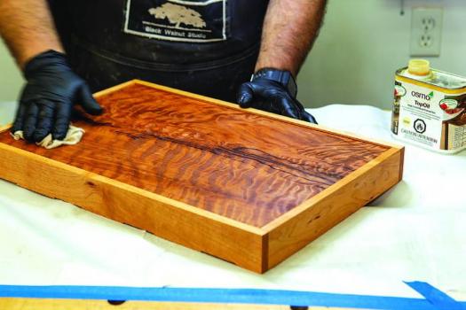

I went with Osmo TopOil for the finish, as it will pro­vide a durable finish and still let the grain shine through. I applied two coats, letting the first cure fully. I propped up the components on dowels to increase air circulation and allow the finish to cure. I also like to apply a fine furni­ture wax, like Clapham’s Beeswax Polish, after the second application of the finish has fully cured.
Wrapping up
Once the finish has fully cured, remove any tape. Sand any spots the finish penetrated or, alternatively, touch up any spots you missed after gluing and assembling the tool­box one last time. Glue some 1/4″ diameter rare-earth magnets onto the top of the square blocks for the flip-down door. Glue these on after adding another pair of magnets to the inside top of the door. Screw the flip-stops, hinges and draw latches into position. Finally, centre the handle between the latches. Some compartments were left a little larger than required, especially on the larger right half, to allow spoon blanks to be carried in this travelling toolbox.
