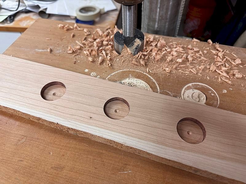

Drill it out

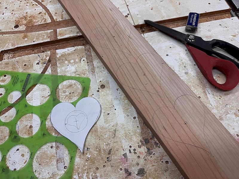

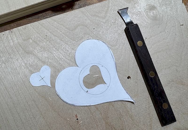

First, a bit of planning to see where the edge of each heart would go, and where the circular recess on the back of each heart should be located. This was done on paper. I decided on a 1-1/2″ diameter hole, though if I had a slightly larger Forstner bit, I would have used it. I think 2″ diameter would have been perfect for this specific project. This just meant that the inner heart was going to be on the small side, as it needed to be entirely inside the 1-1/2″ diameter recess.
Once the planning was complete, I flipped the blank over so I could bore the 1-1/2″ diameter recesses from the back. They were bored to about 1/4″ deep. From there, I drilled a 3/8″ hole in the middle of this hole so I could fit a scroll saw blade through the workpiece to cut the hearts out. I just made sure this 3/8″ diameter hole was located so it would be removed after cutting out the heart shape. An important tip here: I first drilled a 1/16″ diameter hole where I wanted the 3/8″ diameter hole to go, so I could bore the 3/8″ hole through the blank face-to-back. I did this to ensure any chipping from the 3/8″ drill bit wouldn’t be on visible face of the hearts. Drilling the small hole through first allowed me to locate the 3/8″ hole very precisely.

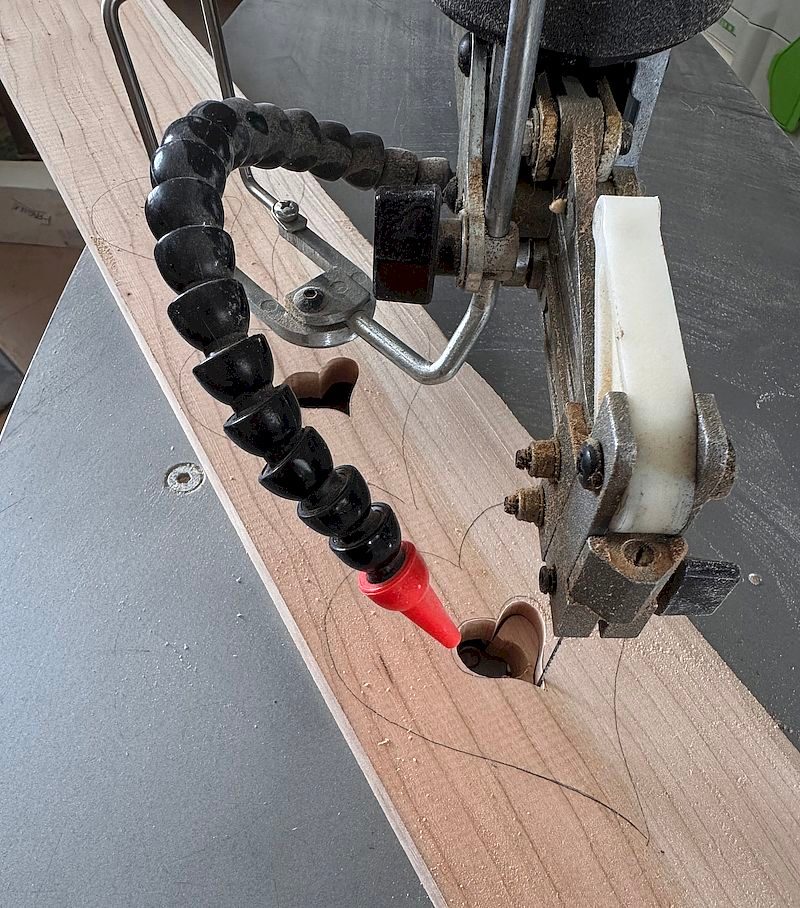

Cut the heart out
At this point, the hearts could be cut from the blank. They’re a lot easier to work when they’re a part of a larger blank. Next, some sanding to even up the edges.
Make the inserts
If I had dozens of these to make, and also needed them to be perfect, I would take a much different approach, but drawing the 1-1/2″ diameter inserts on a piece of wood slightly thicker than the recess was deep, cutting them close, then sanding them to fit was good enough. I then added initials with my pyrography pen. Next, a bit of carefully placed glue, to ensure it wasn’t seen from the front, and a clamp to provide a bit of pressure, and I could let them dry for a while.

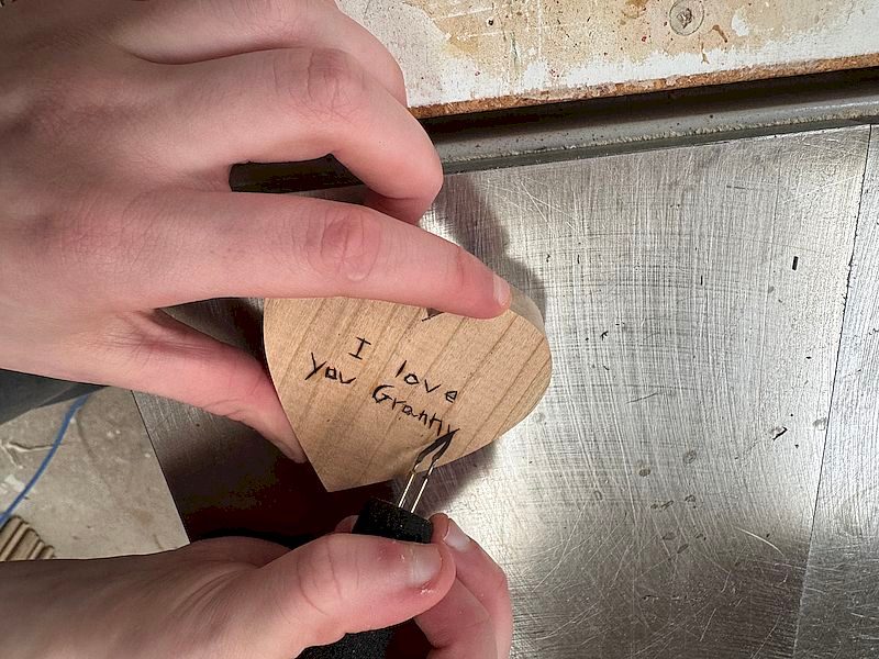

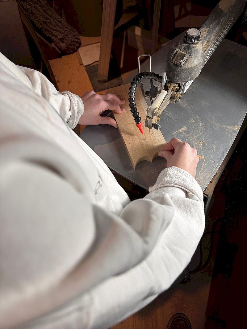

My daughter wanted to make something special for her boyfriend and her grandmother, so I offered to help her make wooden hearts for them. She thought that was a great idea, so off we went to the shop. I helped her break out some material and gave her a few layout tools so she could take care of the rest. She drew the hearts out, cut them on the scroll saw, gave them a quick sand, listened to my short lecture about how more time and effort spent on sanding would make the finished piece look so much better, spent a bit more time sanding, then used the pyrography pen to add names and pizzazz to the hearts. At this point, I helped her apply a few coats of shellac before we brought the hearts home.
By now, my daughter has been in the shop enough to know a little about a few of the machines and tools, which is fun to see. She enjoys making things for people, which is generally the only way to get her into the shop. I’m certainly not complaining, though. On our trip home she said how great it was to have access to a woodworking shop because she could make some cool, unique gifts. It’s sort of like her secret weapon when gift giving comes around, and I can understand that.

Flat-Bottomed Holes
I carefully located holes in the back of blank to accept a contrasting wood insert with an initial on its face.

Careful Layout
The heart must be located within the diameter of the hole drilled with the Forstner bit.

Small Holes
Although you can’t see them, the three 1-1/2" diameter insert holes are already bored in the back of this blank. To locate the centre of the 3/8" holes, so you can insert a scroll saw blade, bore 1/16" diameter through holes from the back to use as guides for the larger holes. Drilling the 3/8" holes from the front reduces any chipping on the finished faces of the hearts.

Cut the Hearts
A scroll saw takes care of the inner hearts.
